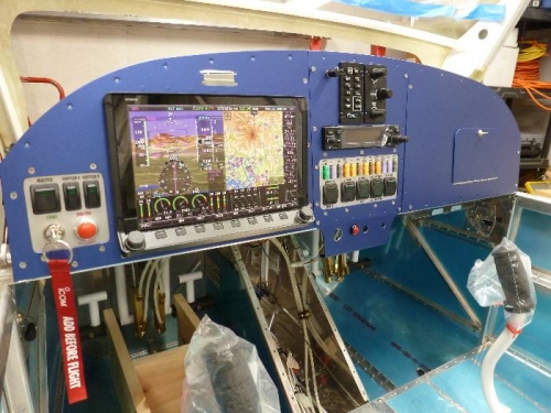

Brief Description:  debur friction comb, apply wrap to instrument pane
Manual 49-09 deburr the friction comb for the heater cable
Apply 3M 2080 wrap to the instrument panels, all three sections. Took quite awhile to get it done but it looks really nice. Used heat gun to set the adhesive. Used exacto knife to cut out large holes, poked holes for the panel screws.
