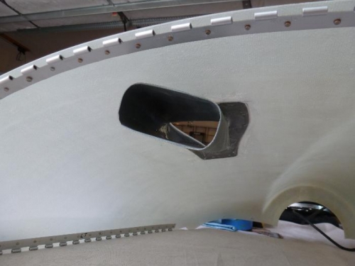

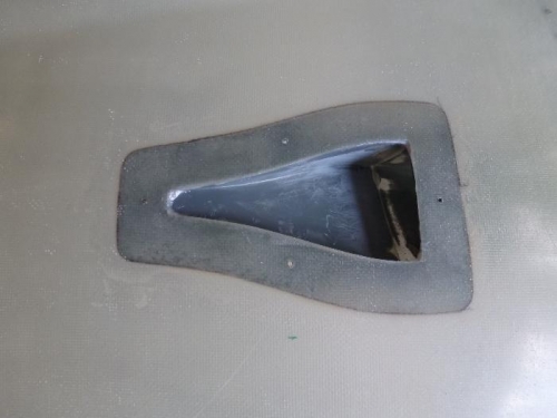

epoxy scoop onto cowl, RTV cooling door
Manual 46-20 step 5 epoxy scoop to the top cowl with flox epoxy, partial step 6 - fill edges of the scoop with flox epoxy
Manual 38-09 step 9 and 10, sand bottom cowl for fir with paint clearance
Manual 49-04 steps 5 - 7, apply high temperature RTV to cooling door
top view scoop epoxied
inside view scoop epoxied
