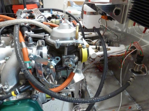

fule line to pressure sensor

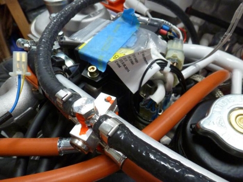

fuel line on the fuel block

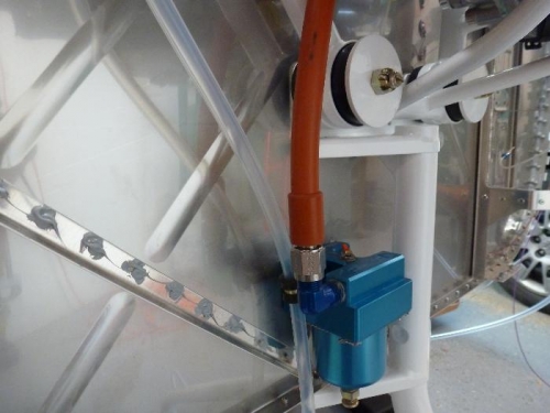

fuel line from gascolator
