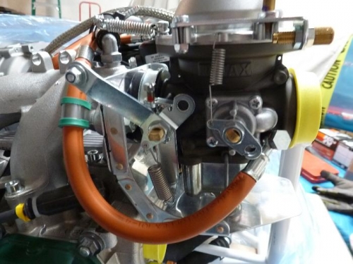

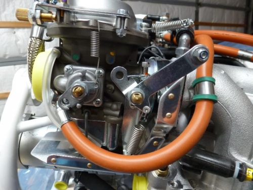

install carb drip trays
Manual 46-07 steps1,2,4 - install drip trays, then carburetors, then spring, tighten carb mount ring. Torqued carb mount rubber interface to 135 in-lbs and applied Loctite 242 per Manual 46u-08 notes.
left carb drip tray installed
right carb drip tray installed
