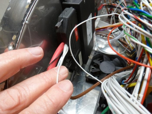

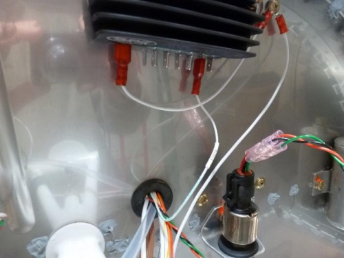

install regulator monitor wire
Manual 46-19 step 6 - install wire WH-P3070 wire on the regulator and run through the firewall to the 37 pin EMS connector pin 9.
WH-P3070 attached to reg.
wire WH-P3070 into EMS
