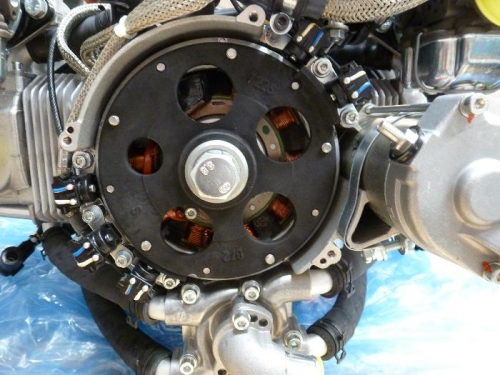

Manual 46-03 steps 3-4, partial 5 - check the ignition coil spacing with feeler guage, used 1" socket to rotate the flywheel instead of using the prop output. Fellow builder Mork Owens verified he did the same after a suggestion by an A&P.

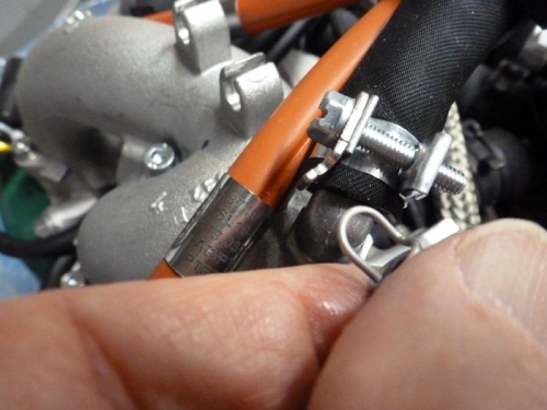

Manual 46-04 step 1 partial on both carbs removed the damping springs on both carbs. Step 3 marked the starter lug ready to cut.
flywheel and ignition coils
carb damping spring removed
