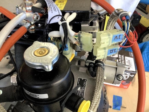

disconnect the Rotax ignition connectors, etc.
Manual 46-02 steps 1-7 disconnect the ignition wires and several scews, etc.

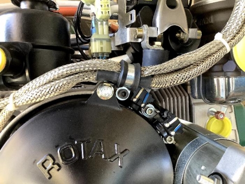

Manual 46-03 steps 1 - remove and install new scew and spacer. Torqued to 55 in/lbs based on Rotax requirement for that screw size.
ignition wires disconnected
new screrw installed (black)
