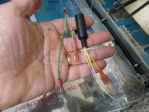

Brief Description:  build the ELT GPS received test tool
ELT Manual - Per page 9 constructed the ELT GPS received test tool LED. Applied a connecton the leads to easily connector to the ELT remote connector. Used a 330 ohm resistor and tested the tool with a 9V battery.
ELT test tool on left
