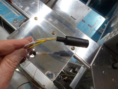

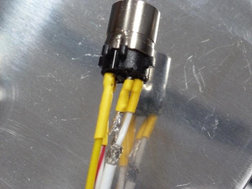

Manual 42F-04 and ELT manual - Installed the ELT remote nameplate per the ELT manual. Soldered the connector for the ELT remote per page 8. A little difficult due to the size and located inside the fuselage so can't do it on a bench.
connector soldered,heatshrinked
connector housing installed
