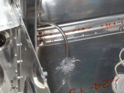

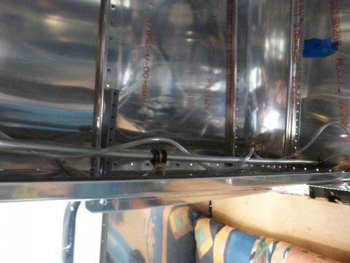

wire tie fuel air vent, rivet shoulder harness lug
Manual 37-08 wiretie the fule tank air vent tube to Fuel vent tube and RTV the clear tube to the rivet and the wireties
Manual 25-03 steps 3 & 4 riveted the two shoulder harness lugs
Manual 25-04 step 1 rivet the shear clips. Shear clips had to be riveted from the tailcone side due to side baggage pieces already installed.
fuel tank vent tubes
RTV applied
