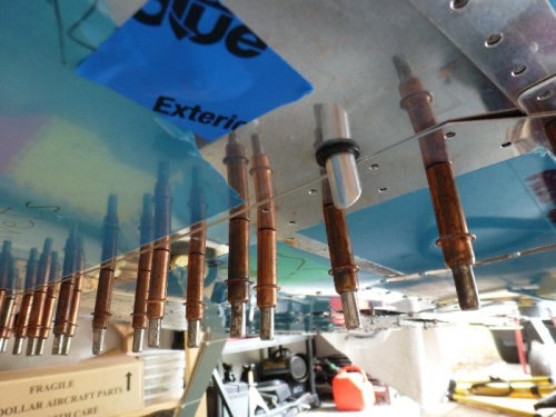

Brief Description:  drill and attach fuel line vent tubes
Manual 37-08 steps 10-16 drill holes for fuel tank vents. Install the T-01219B fuel vent line through grommet in bottom of tailcone. Rivet special rivet and punched out mandrel with an LP4-3 rivet mandrel.
fuel vent through bottom
