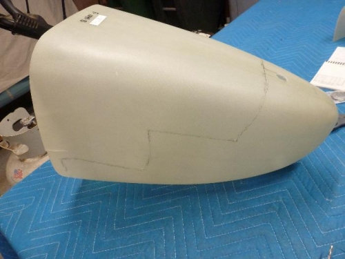

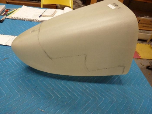

Manual 12-05 step 2 made the four 3/4" masking tape templates for use on the tailcone for the fairing mounting holes

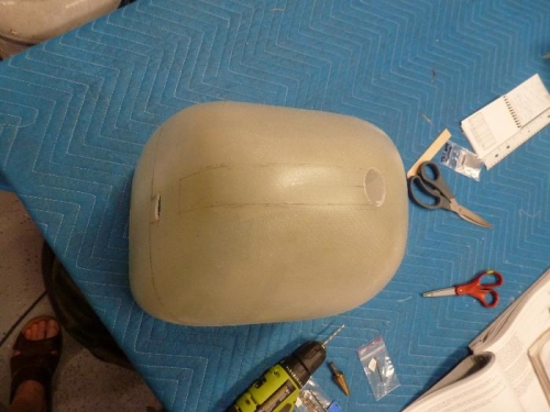

Manual 12-06 step 1 drilled two 3/4" holes in bottom tailcone fairing F-1294B plus four #30 holes. Used a pencil and marked the scribe lines on the fiberglass fairing for better visibility.
Identified the two remaing short cables with connectors on each end as the shoulder harness connecting cables. Put them in with the bag of the shoulder harnesses.
pencil on fairing scribe lines
pencil on other side
end view
end view
