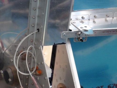

Brief Description:  test mount left wing onto fuselage

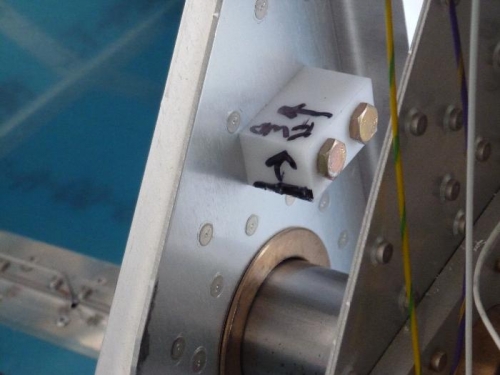

Test mounted left wing onto the fuselage with Cheryl Rodcely and John Webb help. Wing would not fit on all the way, had to temporarily remove the wiring connector to allow ing to go further in. Off by about 1/32 inch. Could not insert the wing mount tube. Plan to file in a couple places on the fuselage to allow slightly more insertion distance. See pictures.
will file where marker is
will file off some where mark is
