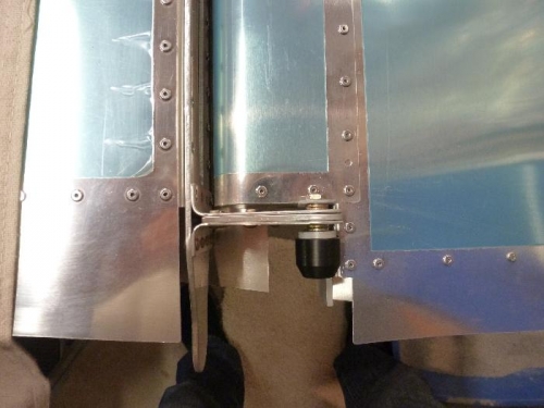

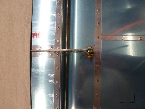

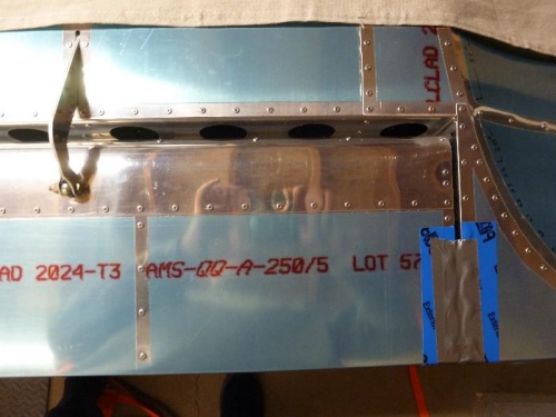

attach flaperon on left wing
Manual 30-04 steps 1 - 3 left wing attach flaperon. Torque all bolts to 30 in/lbs, no torque seal at this point due to possible flaperon removal when wings painted.
left wing flaperon inboard
left wing flaperon mid wing
left wing flaperon outboard
