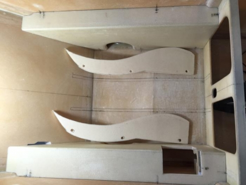

Now that both sides of my support piece was glassed and cured I could cut them out to shape. Once done I checked it against the template jig pieces I'd made for shaping the seat bottom. As you see in pic 1 its a good match so I continued with the seat base jig.

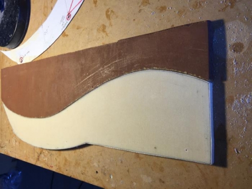

Pic two shows the two support pieces with position lines drawn. I'd also spent a while sanding the floor area ready for gluing.

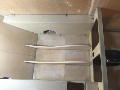

Pic 3 has the supports floxed in place. There are a reasonable fit with a little flox on the bottom. I'll be using BID tapes after this initial join which are what will really make them strong.
I spent a while thinking if I should center the boards to the aircraft centerline or just offset to match the pilot seating and the unequal width consoles. I went for the slight offset as this is then the center of the pilot. After all in some planes that person sits all the way to the left hand side.
Matches template
Matches template
Centered for the pilot space
Floxed in place
Floxed in place
