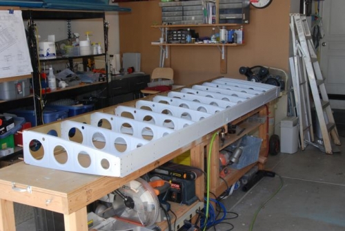

Time for the rivet gun! My beloved squeezer doesn't work here. Assembly of the wing skeletons was accomplised today; 4h for the right side, 2.5h for the left.

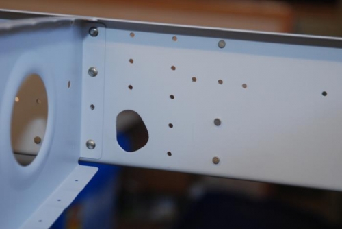

The structure went together quite easily, though it was a bit tight in the area around the wing walk doublers. On the right side, I had to drill out a few rivets. On the left, I assembled the frame without the two inner-most ribs in place. I riveted in 3 and 4 .. 3 was easy to access, and then installed 2, rivetd, and 1 and riveted. The flages face inward, so this gave great access. I won't be so lucky when I have to rivet the skins.

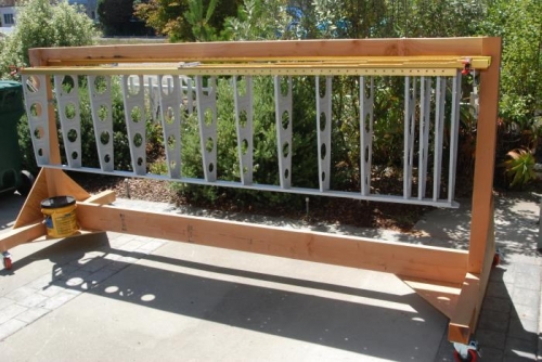

Got to try out my wing stand, too! Works pretty well.
Pretty rivets
Pretty rivets
Voila ... there's a wing here!
Wing skeleton on stand
