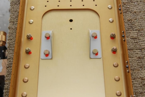

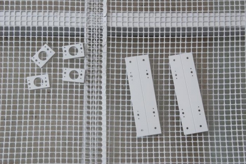

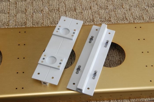

Finalized the build of the wing tiedown mounts, including the spacers. Primed and then installed all the nut plates. Bolted them to the spar, 20-25 oz-in torque for the AN3 bolt (seems low!) Torque sealed all torqued bolts.
Prime ho!
Ready for installation
Bolted in (with torque seal!)
