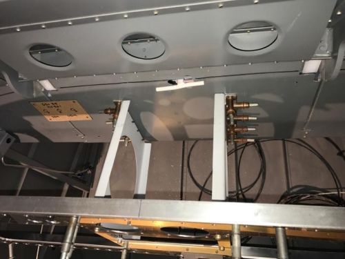

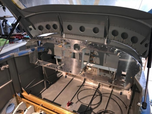

Brief Description:  Fit panel center support
Since the Garmin displays would interfere with the stock panel support ribs, these were cut off to be moved inward.
Now, with the cut panel, the center support ribs can be located and drilled. Fabricated L brackets to join the ribs to the subpanel and drilled the brackets to the ribs and then to the subpanel. Once in place, the panel is solid with this center support.
