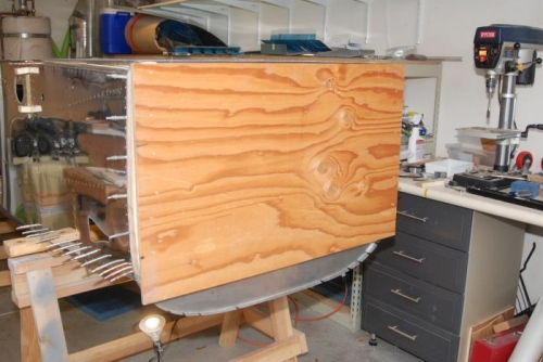

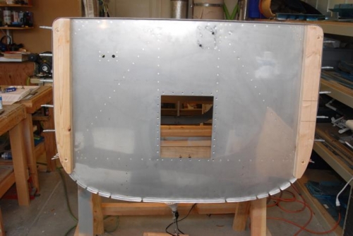

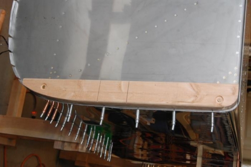

Misc rivet loading and fabrication of the temporary firewall mounting plate for the rotisserie. Drilled and reamed the engine mount holes to 3/16". Fabricated side pieces from 2x3 lumber, match drilled and counterbored the holes. Mounted with AN3 HW and a bunch of for the plywood. Waitng for delivery of the Harbor Freight engine stand to complete the job.
2x3's in on the sides
Details of 2x3 mounting
Plywood panel screwed in place
