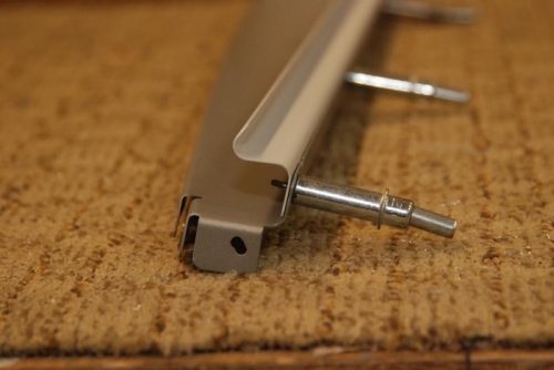

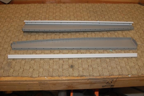

The armrests have been reported to be relatively fragile, so I decided to do a stiffening job per on of the threads on VAF and and add a bit of J-channel to the inside edge. This is an easy and light weight mod, and makes the arm rests much stiffer.
Stiffeners, drilled, dimpled and primed.
Stiffiner edge on
Stiffiner edge on
