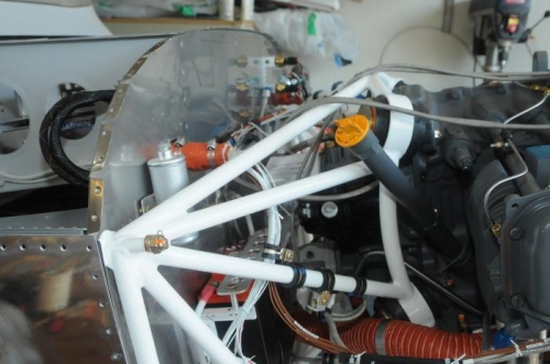

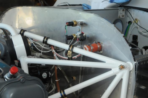

Brief Description:  Sensor wire routing
Ran the wiring for the various sensors FWF - manifold, oil pressure, oil temp, fuel pressure, hobbs oil pressure switch. Routed the wring neatly along the firewall and used numerous set of adel clamps to hold everything securely. Getting good at using the safety wire technique to keep the clamps closed prior to bolt insertions.
Garmin EMS confirms all sensors are functional.
Starting FW manifold termination
Job complete; they all work!
View of right FW penetration.
