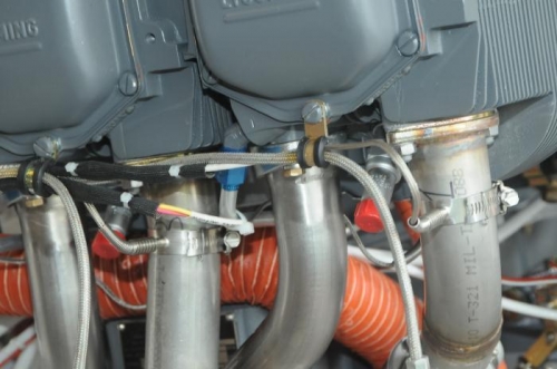

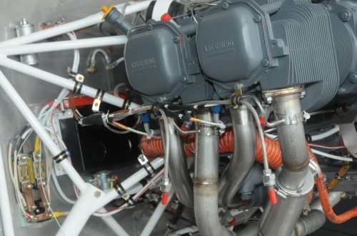

Brief Description:  Route EGT and CHT wiring
Terminate EGT and CHT probes. Routed the thermocouple wire through the feedthrough and to the cylinders. Crimped on ring terminals and attached them to the pre-installed terminals on the EGT/CHT probles. Carefully routed the wires in parallel with the spark plug wiring for a neat and tidy install.
Cyl 1 and 3 wiring
Cyl 1 and 3 wiring
Cyl 3 detail
Cyl 3 detail
Cyl 1 detail
