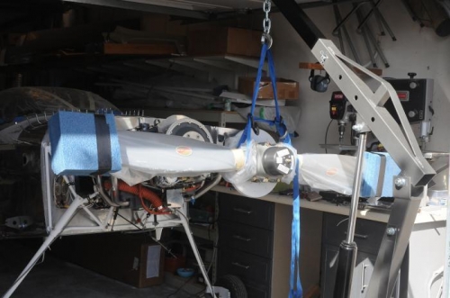

To get a better picture of where the cowl will end up, I figure it was time to mount the prop temporarily. The winch and straps easily held the prop in place and it was an easy, but slow task to engage and tighten all the prop bols, 1/6 of a turn at a time. This way, the spinner plate is in the exact correct location for cowl fitting.
Hoisting the prop into place

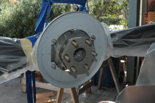

Backside, showing plate and bolts

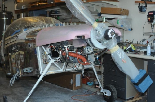

Sure looks like a plane now!
