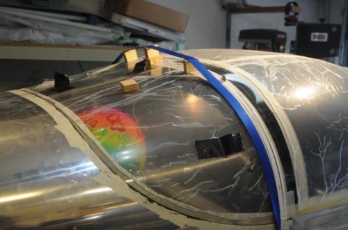

Brief Description:  Install aft canopy, vents

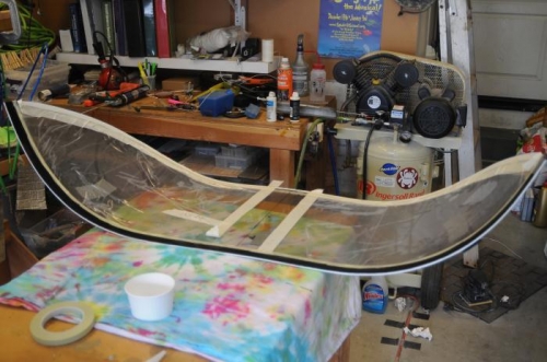

Time to bond the aft canopy to the baggage area skin. Again, I used Sika plexiglass adhesive for this. Masked non-bonding areas, cleaned and primed bonding surfaces (plex and skin), laid in a bead and carefully put it in place (after some dry run tries). Weged the skin in place with some cheap beach balls, and clamped it down to cure. Very little mess, thakfully.

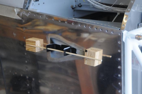

Also bonded the NACA vent ducts to the inside of the cabin skin.
Primed and ready
Primed and ready
Aft canopy in place to curte
Install vent ducts
Install vent ducts
