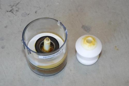

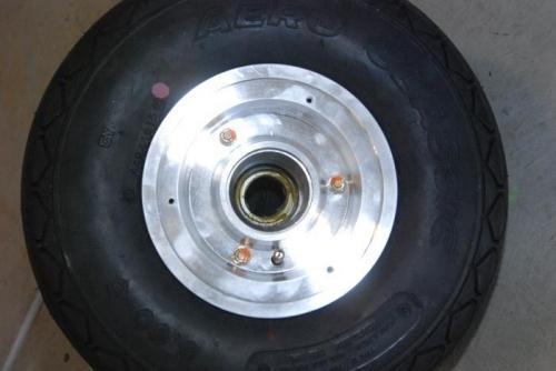

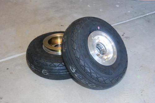

Had some extra time in the shop while epoxy was curing, so let's put the wheels together! An easy job. I used a bearing packer with Areoshell #5 to squeeze in the lube into the bearing spaces, and generously slathered the extra on the inside races in the rims. Everything bolted together easily. Pumed the tires to 35 psi and stored them in a plastic garbage bag to keep them clean. I won't put these on the bird until all the avionics are installed and the gear legs go on.
