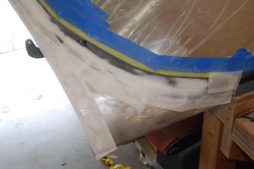

Remove the tape on the canopy skin, sand, fill the gap, and and wait for cure.

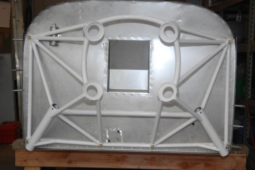

Fit the engine mount. Enlarge the holes the firewall with the mount in place as a drill guide, using progressively larger diameter drills. Ream to final size. Fit bolts.
Fill the gap left by the tape on the skin
Plexi edge of the fillet
Engine mount on!
Engine mount on!
