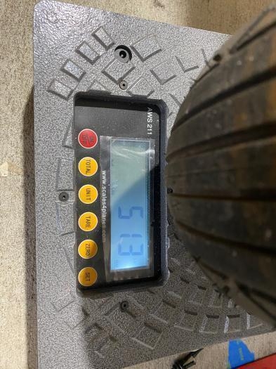

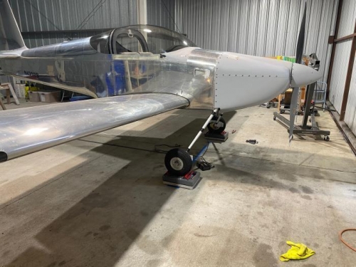

Weight and balance measurements. 7 qt oil, no fuel, all internal and exterior panels in place. No gear fairings; will add those later in phase one, initial flighs will be without gear farings.
Right wheel: arm: 69.20", weight 513 lbs.
Left wheel: arm: 69.50", weight 529 lbs.

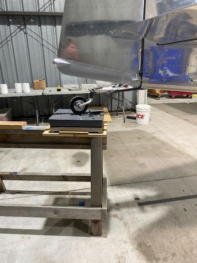

Tail wheel: arm: 239.38, weight 64 lbs.
Empty weight: 1106 lbs
Empty CG: 79.77"
See associated W&B documentation for full CG workups for various loading configurations.

Tailwheel level
