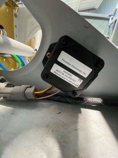

Replaced the Dynon fuel capacitive sensors with Princeton 1S units. They original Dynons were very insensitive (seems to be a known issue); the Princeton units work much better ... higher output range.

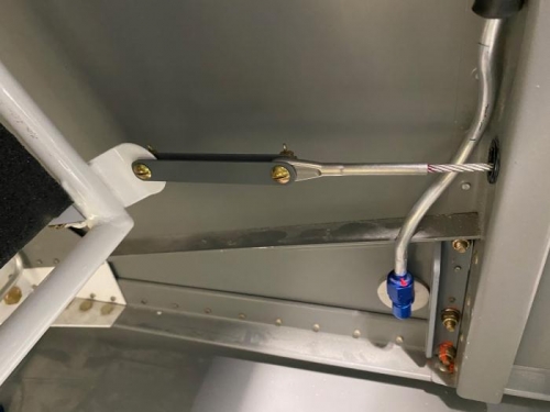

Added the rudder cable / pedal links. 3" center to center is the initial setting based on hangar flying. Will test and adjust.
Princeton Capacitve fuel sensor installed
Rudder links installed
