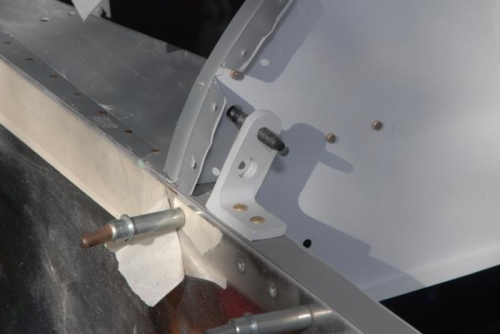

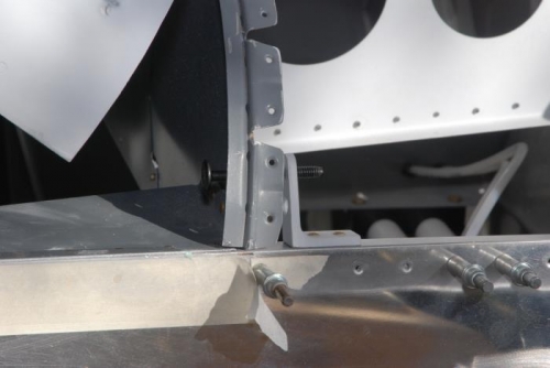

Fabricated and installed a canopy stop/positioner that keep the canopy from being pushed too far forward by the gas struts. This allows a precise adjustment of the location of the canopy with respect to the canopy/fwd skin gap and the aft canopy to tailcone skin gap. Not a standard part of the kit but a great addition.
Positioner side view
Front view
Front view

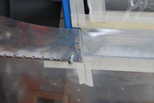

Precise gap!
Precise gap!
