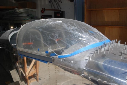

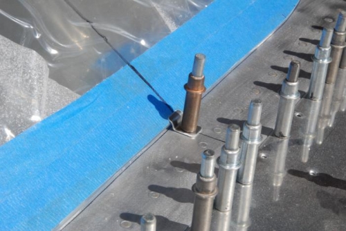

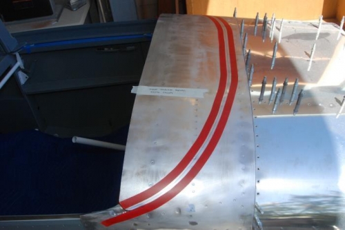

Start the masking opeation for canopy bonding. Mark and mask locations on the skin and and side weldments. Add a positioning clip to the front to help hold the canopy in position while curing. Mask an inital bond line on the canopy skin to receive the initial adhesive. Clean everything carefully!
Canopy final fit check
Forward positioning clip
Masking strips for first round of bonding.
