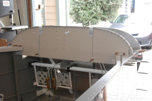

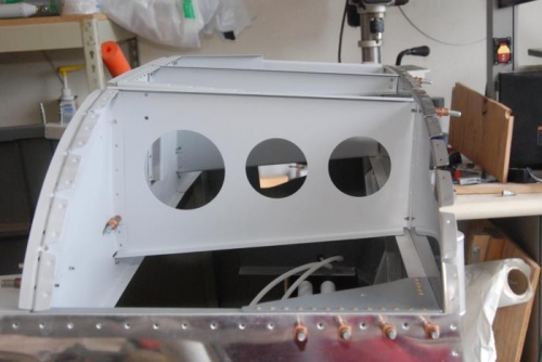

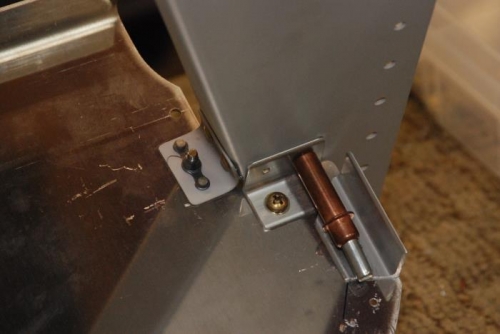

Do fitup for forward deck and locate panel attach brackets. Because of the planned design of the panel, I needed to move the center ribs inward. The ribs were cut flush and the subpanel and will be relocated inward when the main panel is complete.
