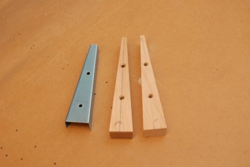

OK ... it's time to bend the trim tab and elevator skins. After lots of research on VAF and other places, I decided to go with the "riblet" method. The reasons are these:
1) I don't want to ruin my elevator skin .. seems like Murphy lives here if anywhere.
2) Before bending, I'd do quite a bit of practice, which would take some time, and still not guarantee success.
3) Building the form blocks would take time, and still not guarantee success.
4) Using the time, I can make riblet form blocks, practice all I want and not screw up a skin.
Making the riblet seems like the lowest risk option and not take any more time than it would if I did it the original way... So, riblets it is!

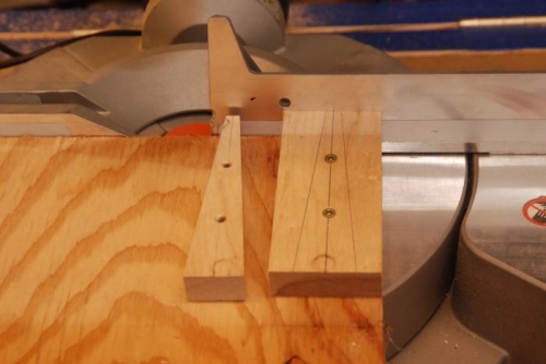

The aviation isle of Home Depot had a nice poplar plank that I used for the block. Made a cardboard template of the rib on the right elevator, transferred it to the block, screwed it down and cut with a compound miter box. A table saw would have been better, but no got one of those. I gave the edge of the bloc a 5 deg bevel to handle springback.

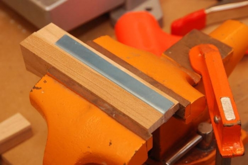

I made two block and clamped them together to do the deed. Worked great the first time out of the gate!
Cutting the forming blocks on the compound miter box
Forming the rib on the block
Voila!
Voila!
