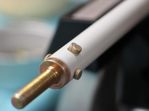

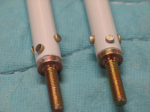

The plans call out a number 12 solid rivet. Well, that seemed really long to me. Image 2 shows a split #12 rivet. This was the first rivet I tried to squeeze. I drilled it out and changed to use #11 rivets with good results. I had to use my "no hole yoke" for these.

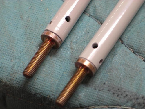

Holes debured and ready.
Split #12 rivet.
Split #12 rivet.
Complete with #11 rivets.
