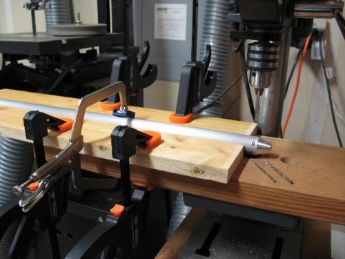

Now as for drilling. Use a center punch for sure. I used my Avery Tools spring loaded punch.

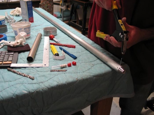

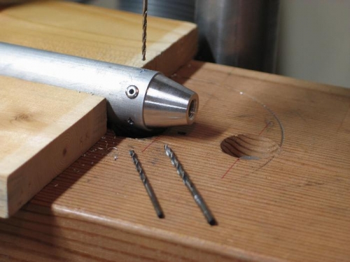

Then I drilled the holes using a 3 bit process. 1/16" bit, #40 bit and finally a #30 bit. Image 2 shows all 3 bits. I clamped the tube as shown in image 1 then drilled the first hole with all 3 bits and riveted it. This one rivet will hold the threaded rod end in place for drilling the remaining 5 holes. I used the 3 bits on each hole before moving on to the next hole rather then drilling 5 holes with the small bit then 5 holes with the medium bit and so on. Lots of bit changing here but I only had to line up the hole once and I got smooth centered holes. I guess you can decide if you want to change lots of bits or reposition the tube a bunch. I think positioning the tube once for each hole is better.
Don''t forget to debur the holes.
I dipped each rivet in primer before pullig it. I actually prefer my cheap $5.00 Harbor Freight puller over my Stanley. It's lighter, and seems to have more leverage. Funny thing.
