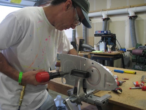

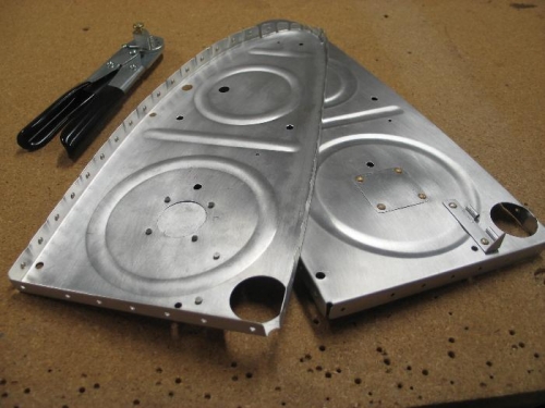

Brief Description:  Plug center hole in second tank rib.
OK, so, I decided to go ahead and plug the center hole in the second fuel tank rib. I saw an email from Vans that told another builder to go ahead and do it. This will keep more fuel in the first tank bay where the fuel pick is durring aerobatics. This is the same rib that has the one way hinged flap door. Fun little job. I didn't have the correct size rivets so I got to use my rivet cutter for the first time. Fun.
Buck 4 rivets to hold plug.
Holes plugged
Holes plugged
