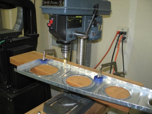

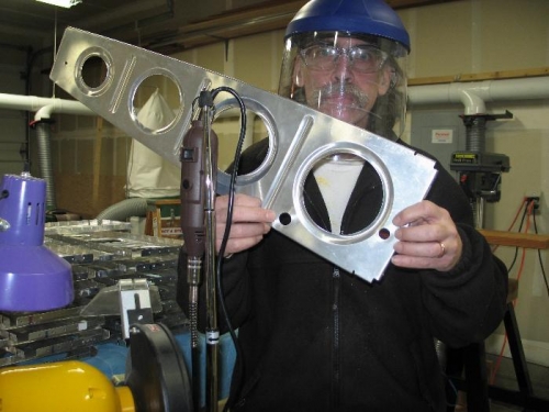

I have heard that the antenna wires need/should be isolated from the other wires. So, I'll need 2 holes. Vans web site has a FAQ that shows what you can do for hole location and size. I enlarged the tooling hole to 5/8" using the unibit. I bought bushings from Vans to snap into these holes. I'll use this smaller hole for the antenna wires. I then drilled a new 0.75" new hole where Vans recommends. I bought tubing from Vans that will run through these holes. The FAQ specifies what to buy.
The unibit will chatter a bunch so clamp it down good. I also found it better to use the unibit in a quick motion rather going through slow.

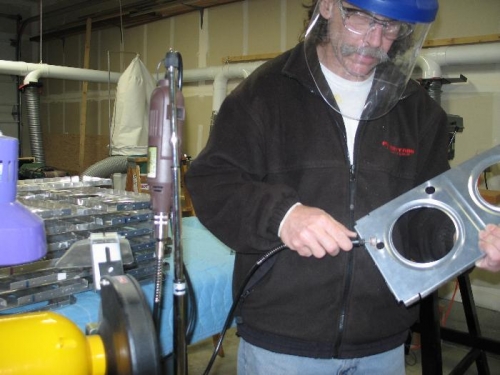

The holes need to be debured, mostly on the exit side. I used my dremel tool with a small medium sanding disk on it. I used the sanding disk as shown in picture 2. Worked great. Use a face shield.
Drill a 0.75
Drill a 0.75" wireing hole.
Small sanding drum to debur.
2 holes for wing wiring.
