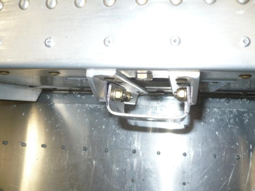

Added longer bolts AN3-5 and another washer to the control bearing.

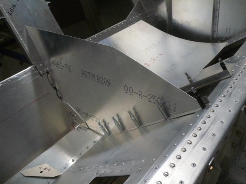

Trimmed 6B18-1's to better fit down into the vee of the front and rear seat panels.
Added 6ZU3-4 seat angles.

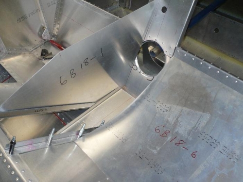

Layed out rivet lines for the seat bottoms 6B18-6.
