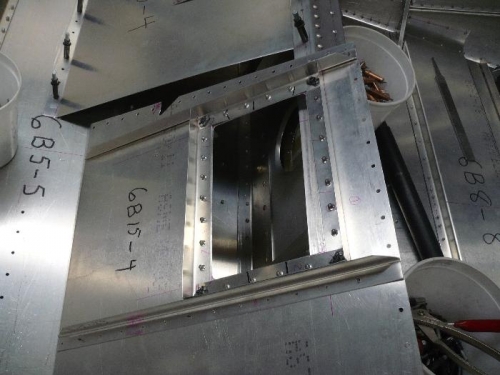

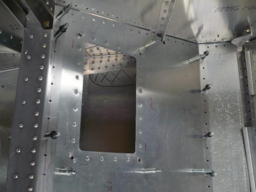

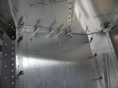

Brief Description:  Adding .040 L angles to front seat panel
Added the short one at the side/bottom then added the long ones around the access hole. Rather than replace I just added them. Still have clearance to attach the main spar nuts at the top and it really makes the panel stronger.
