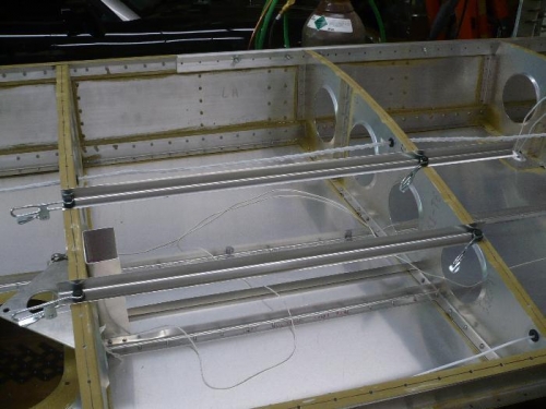

Brief Description:  Finish Aileron bell crank bracing and L-Angles

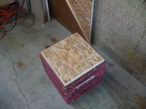

I have 3 of these milk crates that needed a little firming up on the tops. I have used these for years and just wanted to reinforce where I step on them before I go through em. Cut and radiused the wood and held them in place with wire ties.
Held top ribs in place at 520mm with clamps to brace the upper framing for fitting.

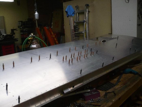

Marked all the L-angles and drilled two holes in the ends to hold them in place so I could flip the skin and back drill the rest of the holes.
Drilled and clecoed for A4's.
Milk Crate revision
Milk Crate revision
