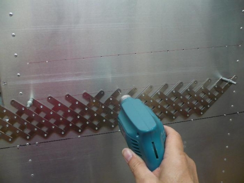

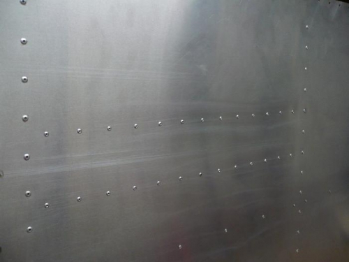

Transfered end holes from cross braces through skin from inside, then used rivet fan for 40mm pilot drill spacing. Marked back through the holes and center punched the center line on the L-angle cross braces, pilot drill L-angles.

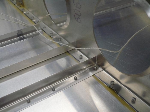

Joggled and radius shaped ends to get maximum coverage.
Bottom btwn ribs 6 & 7
