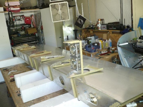

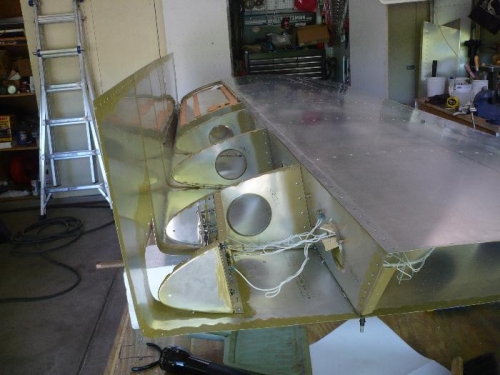

Removed leading edge and nose ribs

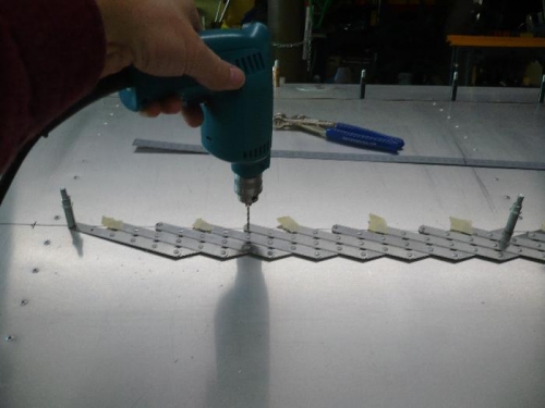

Layed out and drilled for the L-Angles, using every other hole of the rivet fan for 100mm or less spacing. Tape off holes not to be used.
Removed leading edge skin and all the nose ribs, makes it easier to work.
