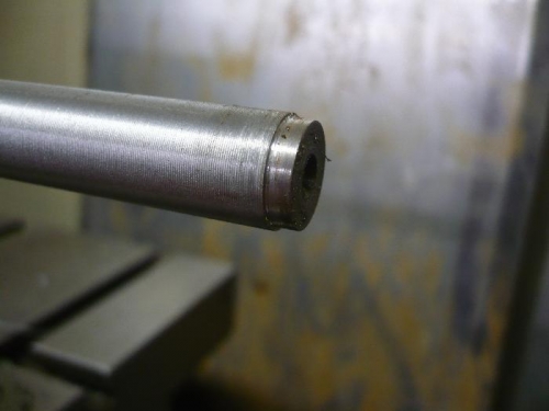

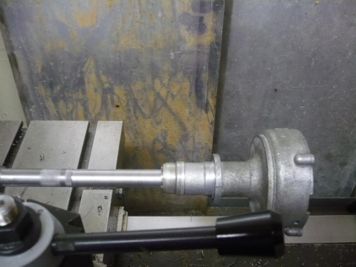

Turned shaft down on center, sneaking up on dimension because it was hard to measure.
Once the OD was established a pilot to the bushing ID was turned on the end.

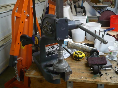

Cut tube to support distributor near bushing before pressing out the bushing.
Turn od so it just fits
Add pilot for bushing ID
Press it out
Press it out
