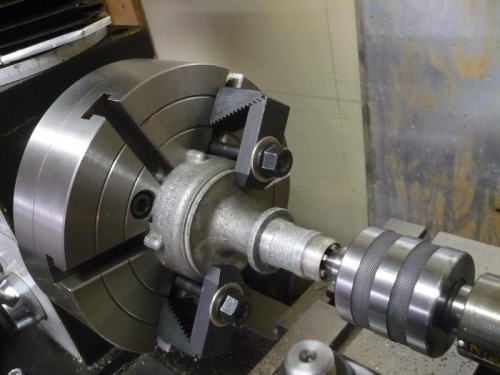

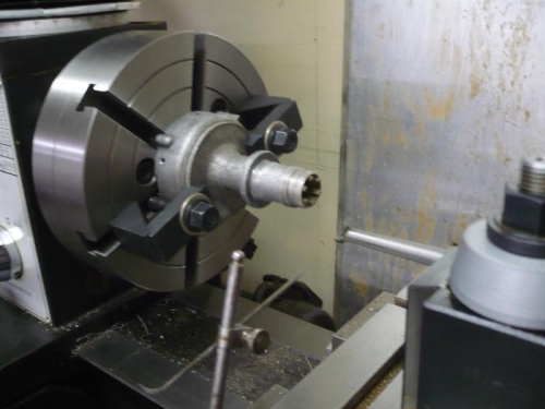

Setup face plate to machine the ID's of Dist Base
Use live center to initially locate distributor base to the face plate and set clamps up.
Indicated in and tightened, double check, triple check.
I will line bore this end for .0015 press fit. There is not quite as much meat here as on the other end.
