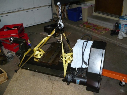

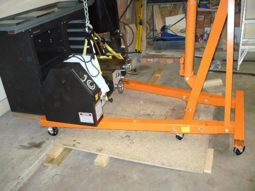

Had to make a ramp and raise the bench up to clear the crane legs. Used pry bar to get the cranes wheels up on the ramp, raised it up at the edge then placed a small piece under the wheels to bring it up to the ramp height. The machine is resting on the legs of the crane as the movement is made. Get it close to position then raise and final position.
