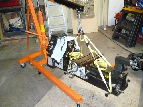

Assembled the Shop Crane to put the machine on its base.

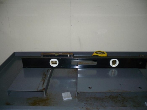

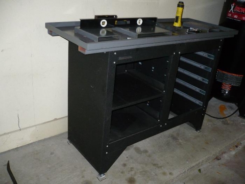

Level the bench first and get it solid. One leg is 1" above the floor to get things level. Had to use shims to set it. Going to make base feet from steel, 3" round should work.
Used slings to lift the machine with the $99 Harbor Freight Shop Crane.
Level length and width
Getting close
Getting close
Slings to lift the machine
