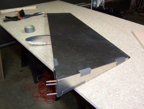

Fitting and trimming the rudder was very straight forward. The manual is quite clear here.

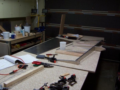

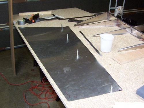

Cleco skin to the table top using 3/32 clecos for the #40 drill. Once it was fastened to the table I drill all the holes except the end ones at the trailing edge.
At the end of the day I have a rudder skin ready for final fitting to the skeleton.
