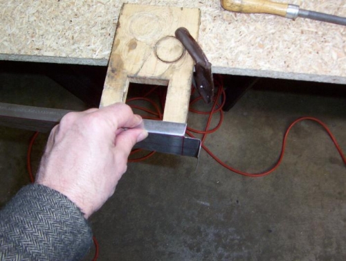

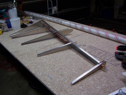

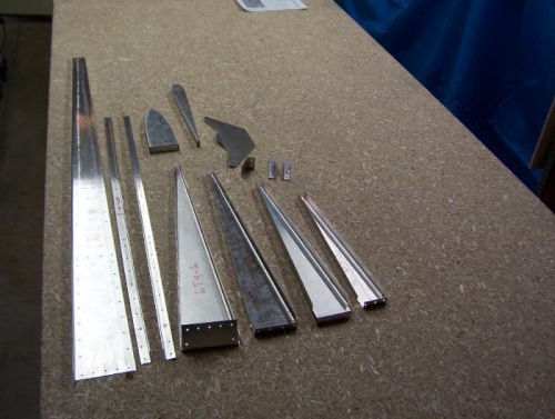

Deburred the rudder skeleton and took a couple of pictures. Pulled another sheet of .016 out to skin the rudder. Image 3 show a trick I use to file parts. Having close backup support for the flanges makes filing more controlled. The piece is rock maple.
Ready to Deburr
Ready to Deburr
All pieces deburred
All pieces deburred
Filing support.
Filing support.
