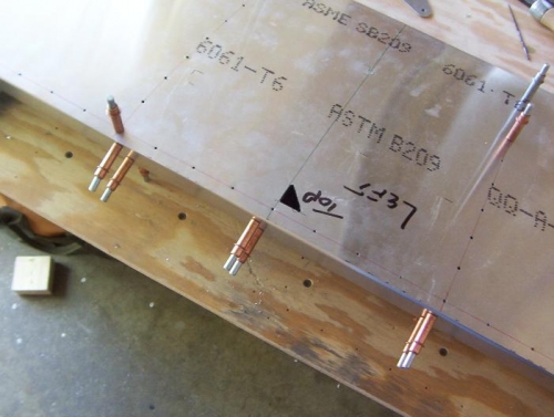

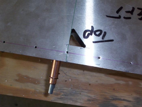

Cut two triangular holes for the Elevator Horn Doubler in the top and bottom skin. Also attached and trimmed the 6T3-7 angle. Stopped there for I realized I need to re-make the Upper Elevator Horn. Missed the dimension by 10mm to short. Have enough material to re-make it and place the hole at assembly.
Hole for Doubler
Hole for Doubler
Through hole Brkt in place
