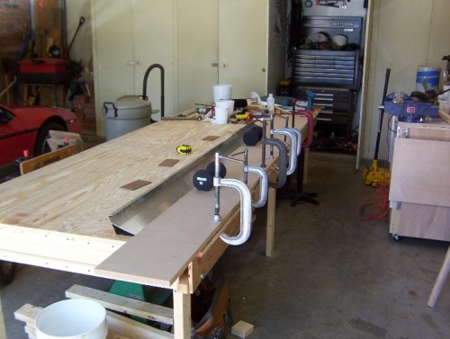

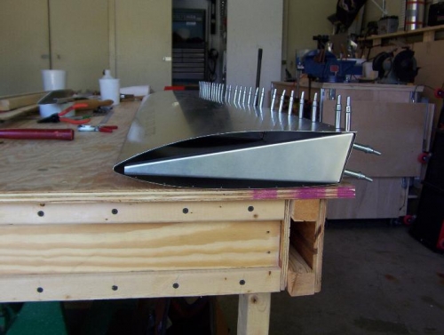

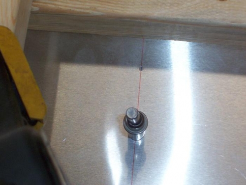

Got elevator skin clecoed in place. Had to spring the skin closed, clamped it down to stop blocks. It came out nice. Finished drilling and clecoed skin in place. Left the hinge holes at 3/32 so I can drill through the hinge then open them up later.
Skin is sprung open
Spring it closed
Lining up rib line through hole
