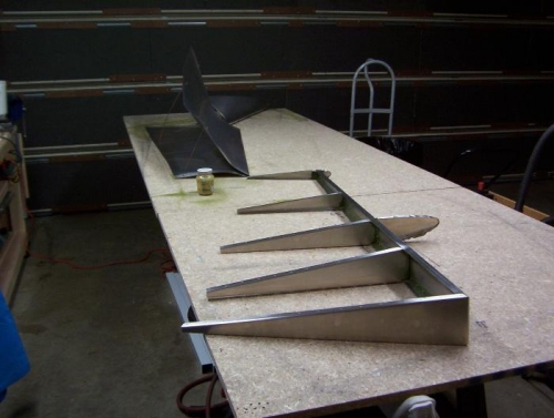

Brief Description:  Trim Rudder Nose and Prime Rudder

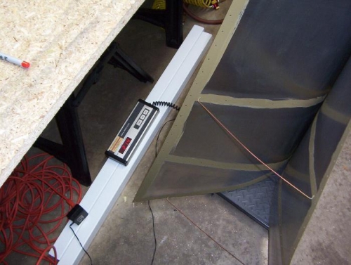

Process: Scuff with Maroon ScotchBrite, Clean with Laquer Thinner till the rags don't pickup any color, Brush on primer using 1" bristle brush, two coats 5 minutes between.
It added 1oz to the skin and 2 oz to the skeleton for total weight gain of 3oz

Everything ready for Primer
1oz weight added to skin
